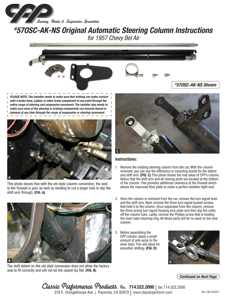

CPP’s 570SC-AK-NS Original Automatic Steering Column Kit is built to make installing an updated steering column in a 1957 Chevy Bel Air cleaner, easier, and better fitting. This kit helps solve common issues found with older column conversions, including poor firewall sealing, carpet interference, and shift arm clearance problems.
The instructions cover the complete installation process, including removing the factory column, transferring reusable components, preparing the new CPP column, installing the neutral safety switch, setting up the rag joint and shaft, and securing the floor plate for a proper seal. When installed correctly, this steering column kit delivers a factory-style appearance with improved fitment, smoother operation, and a cleaner finished look inside the car.
